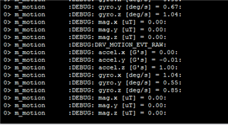

Hi, I'm new to thingy, I want to log the data received and viewed in mobile app / web app from thingy 52 development kit which contains nRF52832. Is it possible to log data? If yes, how to log data, else is there any alternative way to log the data received through BLE from kit.
  • Hi Hemabas,
    Remember that the Thingy:52 is not a Development Kit, but a reference design. So to access the nrf52832 to flash/read you need a 10-pin connector and the debug-out from a nrf52 DK.
    Add this in sdk_config.h.
    #define NRF_LOG_ENABLED 1
    #define NRF_LOG_DEFAULT_LEVEL 4
    Increase the NRF_LOG_DEFAULT_LEVEL to 4 to get out debug messages as you can see in "drv_motion.c":

    Ex.
    Download a fresh copy of the thingy SDK.
    1. Enable nrf_log and set the Log level to 4.
    2. Compile and flashe the application, and connect (BLE) to the Thingy with nrf connect mobile.
    3. Turn on the "Thingy Raw Data Characteristic" in the motion service and get out this from the RTT log:
    (added .hex file:)app_thingy_s132.hex
