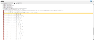

I just updated to the new sdk Mesh 3.0 and SDK 15.2 . I build light switch server and get error :
Please show me the solution for this. Thank.

Same with me and I tried to show diff with earlier version and I found flash_placement.xml is not found, and I tried to put oldflash_placement.xml from v2.2 and solve the prblem
We have updated the SDK .zip file with flash_placement.xml. Please use the updated one.
