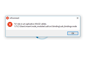

I have already used an earlier version of nrfconnect on this lcomputer( windows 10 language PT-BR).
After upgrading to 2.6.1 I got the the error below:
Translating to english.
" %1 is not a valid Win32 app"
