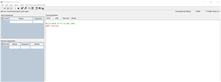

What I do was uploading those codes to the 2 separate nRF52 DK boards and I opened 2 terminal program to see and send data packages to be transferred. The problem started from the beginning. I could see that those two boards are connecting to each other (from the LED's - The status has changed) But when I type a string from the Peripheral device's terminal software no any data has sent to the Client side. Because I check the terminal program on the receiver side as well.
But I managed to test the ble_Peripheral firmware by sending data from my phone through nrf Toolkit&nRF connect software and could see the coming data on the Terminal.
Eventually, I have to be able to communicate 2 boards over BLE. Could any of you tell me what could be the problem I faced and Is there any other 2 way of communication test codes for custom service that sending a simple string or any type of data?
