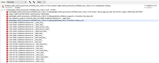

"Unplaced_Sections" error: nRF5 SDK for Mesh v3.0.0 example code (light_switch_provisioner)
I was just trying to build the light_switch_provisioner_nrf52840 code using Segger Embedded Studio. However, I've got a error build/light_switch_provisioner_nrf52840_xxAA_s140_6.1.0_Debug/light_switch_provisioner_nrf52840_xxAA_s140_6.1.0.elf section `.text.sd_app_evt_wait' will not fit in region `UNPLACED_SECTIONS'
region `UNPLACED_SECTIONS' overflowed by 118820 bytes
build/light_switch_provisioner_nrf52840_xxAA_s140_6.1.0_Debug/obj/ble_softdevice_support.o: In function `ble_stack_init':
ble_softdevice_support.c:(.text.ble_stack_init+0x98): undefined reference to `__data_start__'
build/light_switch_provisioner_nrf52840_xxAA_s140_6.1.0_Debug/obj/thumb_crt0.o: In function `memory_set':
What does it mean by 'UNPLACED_SECTIONS'? I was using the latest nRF5 SDK version (nRF5_SDK_15.2.0_9412b96). I've also tried other examples in Mesh SDK, the same error occurs. Is it the problem of my setup or something else? Anyone met the same problem and knows how to solve this? Your help is much appreciated!
Rosa
    The flash_placement.xml files were missing from the nRF5 SDK for Mesh v3.0.0 zip download. This has since been fixed, so if you download the zip again then everything will be in order. I have added the file below, and these are the folders from where it was missing (it is the same file at all locations):
