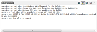

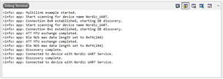

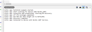

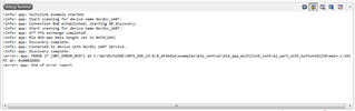

Using [ble_app_multilink_central] and [ble_app_uart_c], I created a program that performs multi-link UART communication, but immediately after the first peripheral was linked
Error 0x011 will be issued.
Please tell me the possible causes.
Thanking you in advance.

  • 1) Button detection is unnecessary, so I deleted "app_button_enable ()" "app_button_disable ()", but it did not improve.
    2) I created the one with the button detection enabled and checked the operation, but I did not improve it.
    3) Since the timing at which an error occurs is after detecting a peripheral, I think that it is related to communication operation or communication setting, is there any problem?
    4) In the current situation, debugging was performed with a program with button detection, but since 0x08 error occurred in "error_error_handler_bare-> error_info-> err_cord" in error setting,
    We are restricting the function and debugging is done only with necessary multi-connection UART communication.
    Attach register information at error occurrence.
    Thank you.
  • 【Reply】
    1) The occurrence of error 0x011 (17) in program execution could not be improved.
    2) When one peripheral is used, an error has occurred in [err_code = ble_nus_c_tx_notif_enable (p_ble_nus_c)] (3) of [ble_nus_c_evt_handler ()].
    3) I think that it is caused by executing [err_code = ble_nus_c_tx_notif_enable (p_ble_nus_c)] (3) twice when one peripheral is connected, but since we do not know how to improve it, do it for each peripheral connection Please tell me how to do it or how it will not result in an error.
    4) Attach log (1) of one peripheral connection and log (2) of connection of two peripherals.
    (3)Error occurrence line.txt
