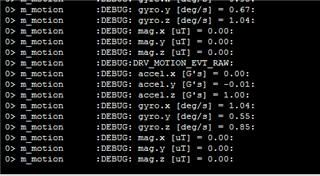

  • Hi Manuel,
    I just downloaded a fresh copy of the thingy SDK.
    1. Enabled nrf_log and sat the Log level to 4.
    2. Compiled and flashed this application, and connected (BLE) to the Thingy with nrf connect mobile.
    3. Turned on the "Thingy Raw Data Characteristic" in the motion service and got out this from the RTT log:
    (added .hex file:)app_thingy_s132.hex
  • Hi Martin. Sorry for waiting.
    I have followed exactly the steps you posted and that didn't work. Maybe the problem is with my terminal or my linux (linux mint 19).
