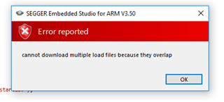

    Here, I adjusted the FLASH_START from 0x26000 to 0x25000, which is in the SoftDevice, and i got the following error message in SES:
    Because the Application overlaps the SoftDevice now. If i was unsure on where to put the FLASH_START address, and lets say I now set it to 0x30000, the Application will not start.
    This is because the SoftDevice I use expects the Application to start at 0x26000 (for this particular SoftDevice). This can be found in the SoftDevice release notes.
