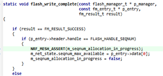

I am running some tests were a Nordic Thingy:52 is sending a lot of messages. Unfortunately, after sending 8126 messages, my sending node crashes with the following:
<t: 7526098>, nrf_mesh_node_config.c, 118, MESH ASSERT at 0x0002EF38
This is always the case, even with different delays between sending (I've tested sending every 25, 50 and 100ms).

- The actual function that causes the assert (which was always there)
I have absolutely no clue what is going wrong and I hope someone can help me. I am pretty new to Mesh and the SDK since i'm a student.

    If you look at my call stack, you can see there are some flash writing actions. I think it has to do something with this but I don't know what.

    This seems to be a known issue with Mesh SDK v1.0.x. You should be able to solve this by switching two lines of code inside seqnum_block_allocate in net_state.c:
    static void seqnum_block_allocate(void)
        if (!m_seqnum_allocation_in_progress)
            uint32_t next_block = m_net_state.seqnum_max_available + NETWORK_SEQNUM_FLASH_BLOCK_SIZE;
            if (next_block <= NETWORK_SEQNUM_MAX + 1)
                fm_entry_t * p_new_entry = flash_manager_entry_alloc(&m_flash_manager, FLASH_HANDLE_SEQNUM, sizeof(net_flash_data_sequence_number_t));
                if (p_new_entry == NULL)
                    /* try again later */
                    static fm_mem_listener_t mem_listener = {.callback = flash_mem_available,
                                                            .p_args = seqnum_block_allocate};
                    flash_manager_mem_listener_register(&mem_listener);
                else
                    p_new_entry->data[0] = next_block;
                --  flash_manager_entry_commit(p_new_entry);
                    m_seqnum_allocation_in_progress = true;
                ++  flash_manager_entry_commit(p_new_entry);
