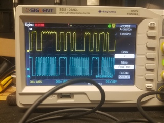

However, I've tried flashing it both to the Sparkfun nRF52832 Breakout as well as the BT832, the latter of which is listed as an official 3rd Party Module on the Nordic website. Both 3rd party boards are unable to scan any I2C slaves, and the COM port just prints "No device was found." I have confirmed that pins 26 and 27 on the third party boards are creating pulses on an oscilloscope, and to me the pulses look the same as the ones created by the nRF52832 that works correctly on the DK. I have also changed the .scl and .sda pins to other ones on the board (I've tried 9/8, 15/14, ...) and have seen those pins I assigned as .scl and .sda pulsing on an oscilloscope, but again the Third Party Modules don't recognize the I2C device and report "No device was found."

    • Can you post screenshots of the scope communication with DK and the modules?

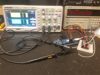

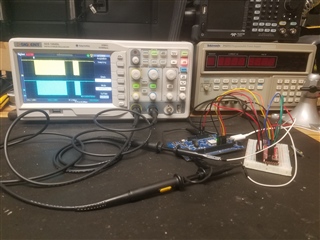

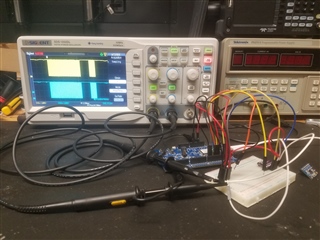

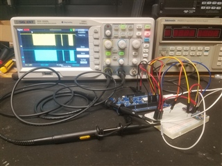

    Sure. These are some very low-resolution screenshots that lets you see the whole signal in clusters, but I will also attach a high-resolution sampling of the first part of the first cluster of pulses (as high res as I could capture with my oscilloscope without signal aliasing).
    DK with 2 I2C devices attached:
    DK with 1 I2C device attached:
    DK zoomed in on SCL/SDA lines:

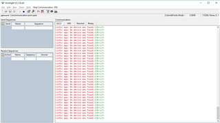

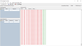

    COM Port when DK is configured and I2C is working:
    Sparkfun nRF52 Breakout Board with 2 I2C devices attached:
    Sparkfun nRF52 Breakout Board with 1 I2C device attached:
    Sparkfun nRF52 Breakout Board zoomed in on SCL/SDA lines:
    COM Port when Sparkfun is configured and I2C communication is not working:
    And the BT832 also had identical characteristics to the DK and Sparkfun board when interacting with 1 or 2 I2C devices.
    I have also attached samples from both the DK and Sparkfun board, they capture the first couple thousand points after the scope triggers on the first cluster of pulses.
    Any ideas on what I can fix to get the Sparkfun or BT832 to recognize the I2C devices? It looks like there is some interaction happening, they share similar characteristics when moving between 1 and 2 I2C devices...

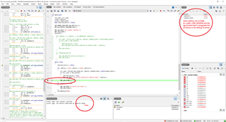

  • Update:
    I decided step through the application in debug mode, working with the Sparkfun 3rd party nRF52832 module (see OP). The only change I've made to the code was enabling NRF_LOG_BACKEND_RTT_ENABLING in sdk_config.h so I can step through in the Debug Terminal:
    #ifndef NRF_LOG_BACKEND_RTT_ENABLED
    #define NRF_LOG_BACKEND_RTT_ENABLED 1
    After doing that and setting a breakpoint on the "NRF_LOG_FLUSH();" right after "if (err_code == NRF_SUCCESS)", ...
    while (true)
            detected_device = false;
            for (address = 0x67; address <= 0x69; address++)
                err_code = nrf_drv_twi_rx(&m_twi, address, &sample_data, sizeof(sample_data));
                    detected_device = true;
                    NRF_LOG_INFO("TWI device detected at address 0x%x.", address);
                NRF_LOG_FLUSH();
            if (!detected_device)
                NRF_LOG_INFO("No device was found.");
                NRF_LOG_FLUSH();
            nrf_delay_ms(500);
    ... I stepped through until "address" read a value "0x68", and the I2C sensor was actually recognized in terminal! I can even remove the breakpoint and press "play" and it works 100% normally, printing "<info> app: TWI device detected at address 0x68." every half-second just like it should have in the COM port.
    However, after exiting debug mode and opening the COM port in Docklight, without changing a single thing in my setup, once again the Sparkfun 3rd party module prints "No device was found." Huh??
    So it seems as though this code works in the Debug Terminal, but not in the COM port. I am very confused. Why could this be happening?
