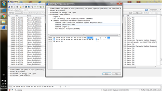

I have very strange problem with the Android phone when connect with nrf51822.
After connection, I used update parameters to set the parameters on the phone side to be like what I want.
My connection paramters are: min_interval: 6 ms, max_interval 10 ms, conn_supp_timeout: 1s.
The first or default from phone is min_interval: 39 ms, max_interval: 39 ms, and conn_suppp_timeout is 20 s.
After request, the all the Android phone returns response to my request with the values: min_interval: 9 ms, max_interval: 9 ms, conn_supp_timeout: 1s.
The sniffer also showed that the update request was accepted by phone side.
The strange thing is:
+> with Samsung and IPhone, I have no problem, after disconnect from nrf51822 ( I just turned off the power), after 1 s, it did appear on phone that the device have been disconnected. This is what I expected.
+. with Oppo and Xiaomi, while in first 20 second when the connection establish, if I turned off the power of nrf51822 after 6 or 7 second after connection, the phone did not disconnect after 1 second, but after 14 or 13 second, which is 20 minus 6 or 7. If it is 16 second after connection then the supp_timeout will be 4 second. After 20 second, it worked like Sumsung or IPhone, which will disconnect after 1 second sup_conn_timeout.
Is there anything I can do to make all the Android phone do exactly what it told to do, which is conn_timeout is 1 second?

    I can't see any issues with the sniffer trace. The connection is updated to use 1 second timeout in both traces. The only difference is that in the oppo_log.pcapng trace, the master continues to send Empty PDU packets for a lot longer than 1 second. I am not sure whether it is actually against the BLE specification, and from the nRFs point of view, it isn't really a problem. The problem is that if the devices comes out of range, the nRF will disconnect (and start advertising) after one second, while the phone will try to resume a connection that the nRF considers lost.
    To me, it sounds like a bug in the phone's OS.
