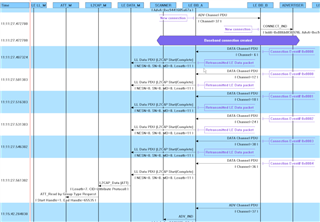

Protocol Analyzer
The BLE protocol analyzer showed that the connection was successfully established and the central tried to read out the primary service, but no response was received. After that, no communication occurs until after around two minutes. At that point  BLE_GAP_EVT_DISCONNECTED occurs and the devices advertisings are visible again. (see screencap below)
