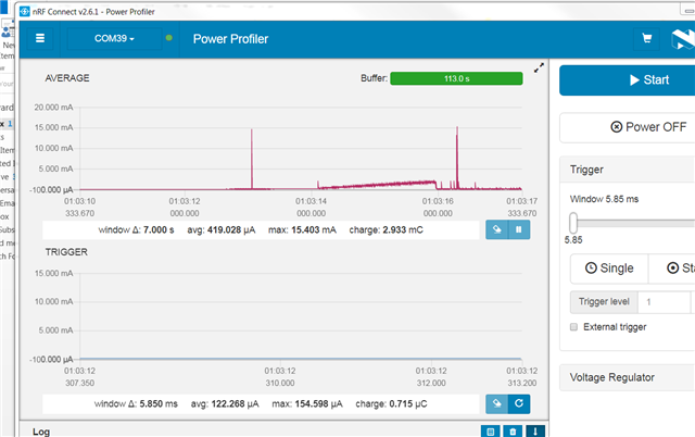

Power consumption starts out reasonable, then ramps to unacceptable levels
So I can live with the 60uA power draw I get shortly after a power cycle but the strangest thing happens.  Over a short period of time the power consumption ramps up to, well take a look:
This page https://devzone.nordicsemi.com/b/blog/posts/optimizing-power-on-nrf52-designs has good ideas for troubleshooting power issues but leaves me wondering just how do I figure out which peripherals are being turned on (and left on)?  The power controls aren't documented (except for the NFCT and that only via the forum).
Any ideas?
