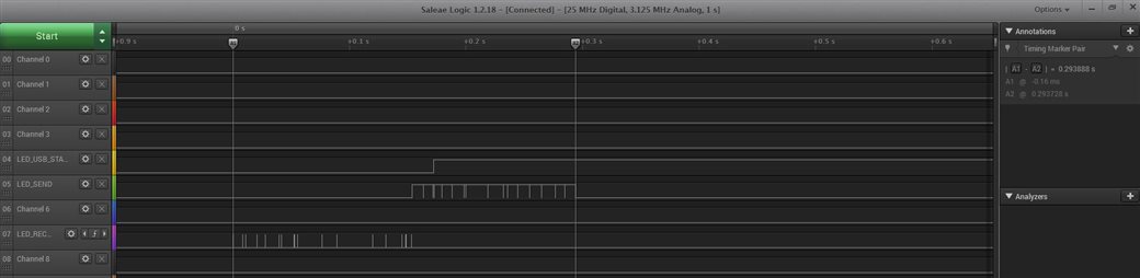

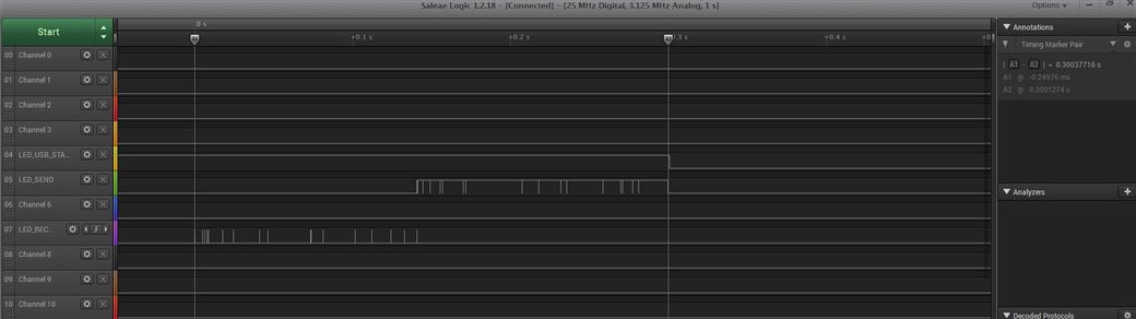

  • Hi Sigurd,
    I actually moved away from using the usbd_msc example. I modified usbd example and now I can transfer data in between host and device. But I have issues with usb speed now and I need more help to debug this issue.
    I'll describe the problem here but if I need to create a new ticket for this problem, I will.
    The host side is using libusb-1.0, sending 16 X 64  = 1K bytes bulk data from ENDPOINTOUT1  using libusb_bulk_transfer function and after the device receiving 1 KByte data it's sending back the data to the host on ENDPOINTIN1. Data is transferred correctly but the time spent to do just 1 KByte transfer is very long and varying a lot. I measured varying rates from 2 - 100 KBytes/second. I tried various libusb drivers (winUSB, libusb-win32 and libusbK) to see any variation with data rate but didn't see any difference.
    I'm  attaching the main.c for convenience.

    I'm measuring the time spent to send and receive data on the usb device toggling LED's and measuring those using a logic analyzer.
    Using LED_SEND to measure time spent on ENDPOINTIN1 and using LED_RECEIVE to measure time on ENDPOINTOUT1.
    My understanding from the nRF52840_PS_v1.0.pdf,  usb has to run with the high frequency clock (which is 64 MHz ?) However even I don't start hfclk in clock_init function (I comment out all clock start and request functions, from line#1030 to line#1040) I don't see any differences with the speed. It varies but it is very slow compared to expected bulk transfer rates.  At this point I don't know how to debug this speed issue further. I'm attaching two captures showing the SEND and RECEIVE times with and without hflck enabled. Can you please help with this?
    Thank you and Best Regards,
    Asli
    USB device receive and send time, hfclk disabled
    USB device receive and send time, hfclk enabled
     I'm leaving for vacation, so I will unfortunately not be able to follow up your question. I would therefore recommend that you create a new ticket for this USB speed issue.
    Edit: For anyone else reading this case, the new case for the speed issue can be found here.
