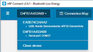

I use PCA10059 with Programmer in nRF Connect 2.5.0 withou any problem.
Now the nRF Connect ask to upgrade to version 2.6.1 and programmer upgrade to 1.0.0.
nRF Connect 2.6.1 ask me to upgrade PCA10059 bootloader, I say "Yes" and now nothing is working !
Dongle is correctly detected:
But nRF Connect can't comunicate with dongle:

2018-12-10T16:05:19.329Z INFO Validating connectivity firmware for device with serial number EA0B74C24AA2...
2018-12-10T16:05:19.334Z ERROR Error while setting up device EA0B74C24AA2: Missing serial port
2018-12-10T16:05:19.337Z INFO Device closed.
2018-12-10T16:05:21.390Z INFO Validating connectivity firmware for device with serial number D4FB1A453A69...
2018-12-10T16:05:21.393Z INFO Connectivity firmware is valid.
2018-12-10T16:05:21.393Z ERROR Unsupported device with serial number 'D4FB1A453A69' and traits ["serialport"]
And When I push the bootloader button, the red LED never blink !
What's the best solution to program again my PCA10059 ?

  • Have you tried to remove the dongle & insert it again & then press the bootloader button? Does that work? I have also updated to the latest programmer app & updated the bootloader, but it worked fine on my dongle.
  • I have tried to remove and re insert and I have pressed the bootloader button...
    Nothing !
    When I plug there is a very small blink (green or bleu LED), and USB enumeration is ok, but button as not action
    I have tried on a second dongle and it's the same... Nothing
    Enum is attached:
