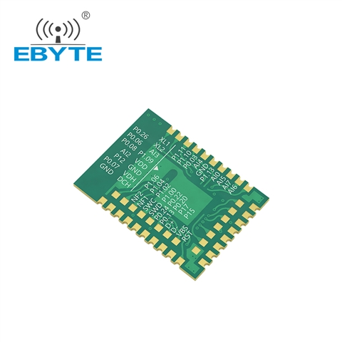

Hi i just bough module nRF52840 from EBYTE.
i test with peripheral work as normal but example Bluetooth Uart not working .  i uploaded success but no device found from my phone.
does module need crystal 32.768khz or not ? because this module don't have crystal 32.768khz

  • I have the same module. Did you buy a separate crystal and connect to XL1 and XL2, and got it working? Do you have a link for which crystal?
  • It works allright. You can use any barrel shape 32khz crystal no need for caps even. See github.com/.../Crystal

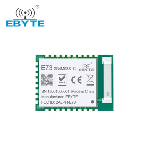

  • Thanks joric. My module looks exactly the same as in the pictures above. However, in the specifications it specifically states is has a 32.768 RTC with a picture of the crystal oscillator. In the manuals schematics Dec 4 and Dec 6 seems to be connected externally. I haven't pulled the aluminium casing off to check if the crystal really is there though. Is the specs simply wrong? ( http://www.ebyte.com/en/product-view-news.aspx?id=445 )
    I got it working by using RC ocillator with config below. However I think crystal will help with accuracy and stability, and power consumption to some extent? And is there a certain frequency I should go for in a external crystal?

  • There's no 32k inside. There's 32m inside. There's no space for 32k. It is optional extra that you solder externally, it does almost nothing it's really negligible unless you have firmware that doesn't run without it. If you don't have it you'd have to replace all mentions of NRF_CLOCK_LF_SRC_XTAL to NRF_CLOCK_LF_SRC_RC. That's it, I'm done here. I gave you the link above, read it.
