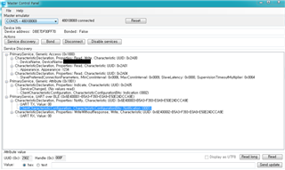

BLE Slave Module: nRF51822, s110 v6.0, based on UART over BLE application example
Chromebook: ASUS C101P, Chrome os 70.03538.110 (32 bit)
I have a BLE slave module(nRF51822, s110 v6.0, based on UART over BLE application example) which is working well with Android, iOS, S120 v1.0.
Below is a capture image from Master Control Panel software for this slave module.
As it is shown, this module uses Nordic UART over BLE service with TX and RX characteristics.
For Tx characteristic(Slave -> Master), it uses notification type.
  (you can see if you click this image icon)
