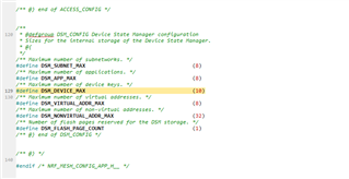

I use the example Interactive PyACI and do as the usage do. when I provision more than 10 server nodes (No power off the serial board),it can't work at all.
I check the serial source code and find the reason in  nrf_mesh_config_app.h  as below:
the DSM_DEVICE_MAX limit in 10
Now I wanna change it to 50
then another problem comes,when I provision nodes more than 32. the same  error occurs.
 in my opinion it should provision node up to 50,but not.
So, what should I do for  "DSM_DEVICE_MAX" in serial example?
