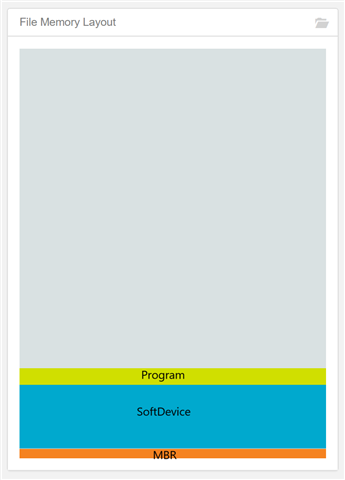

  • I tried to this but the green led doesn't turn on..only the red one was blinkyng..
     SDK15.2.0\examples\ble_peripheral\ble_app_blinky\pca10059\s140\<your favorite compiler> and
     SDK15.2.0\components\softdevice\s140\hex\s140_nrf52_6.1.0_softdevice.hex
    must to be broggrammed both on the dongle? which one first? anyway nrf_connect programmer give me the error
    ''some of the hex files have overlapping data'':   what could i do now?
  • is only to put the : SDK15.2.0\examples\ble_peripheral\ble_app_blinky\pca10059\s140\<your favorite compiler> on the dongle because there is the softevice yet?
  • I believe the ble_app_blinky hex already has softdevice in the package.
    Program the dongle using the hex file in
    nRF5_SDK_15.2.0\examples\ble_peripheral\ble_app_blinky\hex\ble_app_blinky_pca10059_s140.hex
    Here's a reference picture for how the memory is laid out in nRF Programmer
