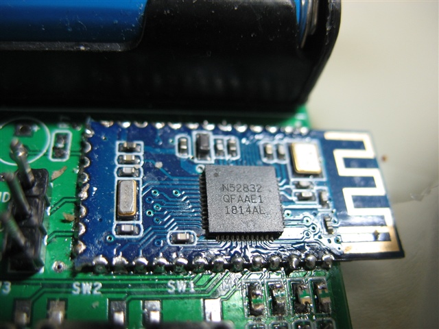

As stated in the other case you opened, https://devzone.nordicsemi.com/f/nordic-q-a/41688/why-there-s-no-errata-for-nrf52832-marked-aaffe1, we cannot find the trace code in our production database. Please provide a picture of the IC where the markings are visible. Which distributor did you purchase the ICs from?

I bought 3 modules online, not chips.

Ok, will forward this to the QA department, but the marking QFAAE1 indicate that this should be a Rev 2 nRF52832, as shown in the IC revision Overview, i.e. Ex0 where x is number from 0..9
Ok, there should be an errata for it, which is not released yet, right?
The Errata for the QFAAE1 is identical to the QFAAE0 Errata as we have not issued any Product Change Notification, i.e. the QFAAE0 is identical to the QFAAE1. So you can find the errata here.
