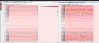

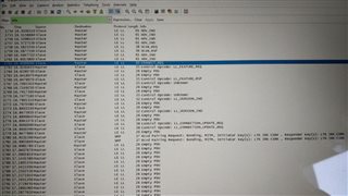

nRF52832,SDK13.0.0, s132,example ble_app_hids_keyboard. The Slave didn't respond the Master that SMP 37 Rcvd Pairing Request: Bonding, MITM, Initiator Key(s): LTK IRK CSRK , Responder Key(s): LTK IRK CSRK
hello! i have a problem ,when the Master send Slave SMP 37 Rcvd Pairing Request: Bonding, MITM, Initiator Key(s): LTK IRK CSRK , Responder Key(s): LTK IRK CSRK,but the slave didn't responds anything,why? i compared with normal(left) and  abnormal(ritght) flash from 0x71000 to 0x71FFF as flow pictrue 1,and when i  used the  red zone of normal replace the red zone  of abnormal, and it worked,connected(bonding) suceed, i am very confuse abut this?
                       pictrue 1                                                                                                      pictrue 2
    Could you clairfy :
    - The normal and the abnormal has the same firmware ? What is the difference between them ? Did you have difference central ?
    -Which firmware do you have on your device ? If you try with our unmodified example in the SDK do you have the same issue ?
    - Could you send us the sniffer trace in both cases normal and failed ?
