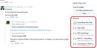

Note that the forum lists a selection of Related posts:
I suggest that you explore some of those ...
