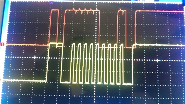

I was trying to communicate with an I2C device, which's address is 0x7C
But I always got NRF_DRV_TWI_EVT_ADDRESS_NACK event, so I took a check on the TWI wave:
Looks like the signal on SDA is correct but the SCK signal is 1 cycle later than normal, that make 0x7C as 0x80.
Why this could happen? is it an issue missed in errata?

    I looked closer at the logic trace and it does not match the description. I do not see any problem with it, except for the fact that the slave nacks the transaction. After the start bit the bit pattern is 11111000 (0x7C<<1 = 0xF8) followed by a 1 (nack). So it seems you write what you intend to, but for some reason the slave nacks it. Where do you get the number 0x80 from?

    Yeah, it looks like 0x7C on SDA, but if you read it per SCL wave as I2C protocol says, it's 0xf8, that's why it can't get ACK.
    I am not able to see that. Looking at the plot (where I assume SDA is the top line and SCL the lower line) all seems to match with the I2C protocol as far as I can see. There are clearly several '1's in the beginning (rising SCL with SDA high), so I don't see how you can interpret it as 0x80 ("10000000").

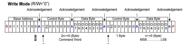

    Could it be that this is just a classical I2C confusion about whether the read/write bit should be included in the address or not?
