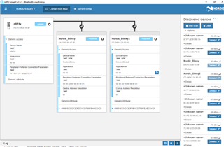

  • Your screenshot shows two Nordic_Blinky peripherals.
    As the linked documentation says, the NUS example should appear as Nordic_UART.
    I need a simple script. A file version to write to the central, which receives several simultaneous connections and sends through a UART interface, and a version for the peripherals to connect to the central.
    It is your job to develop that.
    As already explained, the Nordic UART examples give you a starting point from which to work - but they are not ready-made solutions.
