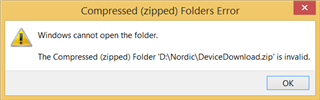

  • Thank you Bjørn
    I downloaded the ZIP for 12.2.0 called DeviceDownload.zip, but Windows 8.1 fails to open it.
    I will retry download in the new year.
    All the best!
    Regards
    Jacques
