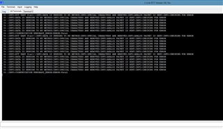

    Try to define DEBUG in your preprocessor defines, and watch your log (RTT log, not UART). Use J-Link RTT Viewer to monitor the RTT log.

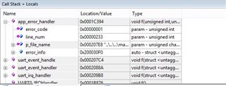

  • Hi Edvin, i am not able to come out of APP_UART_COMMUNICATION_ERROR, please suggest me solution for this
    thank you,
    with regards,
    shrushrutha
  • Hello shrushrutha,
    I am sorry for the late reply. Most of our support engineers have been away for Christmas holidays.

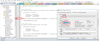

    I see. The way to avoid the fatal errors on Communication errors is simply to comment out the APP_ERROR_HANDLER(p_event->data.error_communication);
                // APP_ERROR_HANDLER(p_event->data.error_communication);
    But you should be aware that when you get this event, something weird has happened on your UART, and you may have lost a UART Packet.

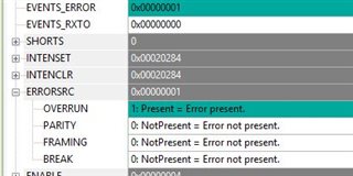

    Do you use the same baud rate on both devices? Is your buffer filled? Can you check what the value of p_event->data.error_communication has (by debugging)?
    The bits of this is described in the reference manual.
    Please find the nRF51422 reference manual from this site. On page 155, you should see table 279: ERRORSRC which is the UART error register. The value from p_event->data.error_communication is reflected here. Do you get a framing error? This suggests that you are either having a mismatch in baud rates, or that you have some floating pins (the UART is not connected).
    Edvin

    after sending around 30 packets  i am getting overrun error. even if i use hardware flow control and reduce the baud rate same error is coming.
