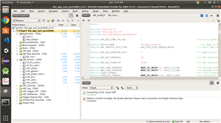

Cannot connect to external nRF52832, no idcode detected
Hello, I'm trying to write code to a custom PCB with a nRF52832 using the nRF52 DK and the following wiring:
However, everytime I try to connect the JLink is says that there is an error and that no idcode detected, see this screenshot below:
So, I'm doing something wrong?, I can write code to the internal nRF52832 chip, I noticed that the onboard chip is a nRF52832_XXAA and mine is nRF52832_XXAB, however I changed the project options to select that target and still the error shows up, I think there's something wrong with the SWDIO and SWCLK pins, as if I disconnect those from my custom board I just get the same error without noticeable changes, anyone can help me?

  • Hello Hung, okay, here is the setup:
    Please look closely, there is a green wire coming out from nRF5 DK to the bottom right corner of my custom PCB (On J5), that's the positive input of my PCB, and the black wire is ground. Now, I have J3 on the top right corner, that's where the connectio to SWDIO and SWDCLK is made, the yellow one is SWDIO and the green one is SWDCLK, the blue one goes to VTG, as the PCB is powered by the nRF5 DK if the power goes through well J3 should have VDD too, so the nRF5 DK will receive the signal to program the external chip.
    Now, I'm 100% sure that my connections over J3 goes to SWDIO and SWDCLK as I checked continuity multiple times, once I power up the nRF5 DK I can measure 2.9V over pins 48 and 45 in the nRF52832, so I believe it have power.
    What I'm doing wrong?
