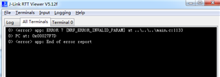

I can not transplant SDK15.2's ble_nus into my project, there is no errors after i complie it, but when it does not work, I use RTT to see the errors, like this:

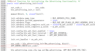

line 1133 is here, i really don't know how to solve it,thanks very much.
Now, I have solved it, but the services_init() should be done before advertising_init(),then it works, WHY????????????????????????
