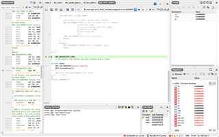

I can build it, but when I run debug mode, the Thingy stops while running nrf_pdm_task_trigger(NRF_PDM_TASK_START) in nrf_drv_pdm_start function of nrf_drv_pdm.c.
Following image is when the Thingy stops.
I also uploaded my projects in Dropbox.
I can't debug deeper than nrf_pdm_task_trigger(NRF_PDM_TASK_START).
What's the cause of that?
