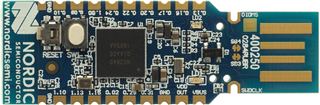

I have just purchased a nRF52840 usb dongle (https://www.mouser.in/ProductDetail/Nordic-Semiconductor/nRF52840-Dongle?qs=gTYE2QTfZfTbdrOaMHWEZg==).
I would like to transfer data from linux PC to nRF52840 dongle over USB and it can be read through any custom characterstic.
Is it possible to achieve this ?

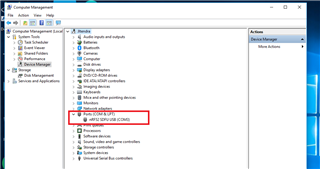

    Then I tried nRF5_SDK_15.2.0_9412b96\examples\peripheral\usbd_ble_uart example. It worked for windows. I have got virtual com port. I can open com port and transfer data from pc to mobile app and vice-versa.
    But I am unable to get any com port in linux pc (ubuntu18.04). What can be issue?
    Jitendra
