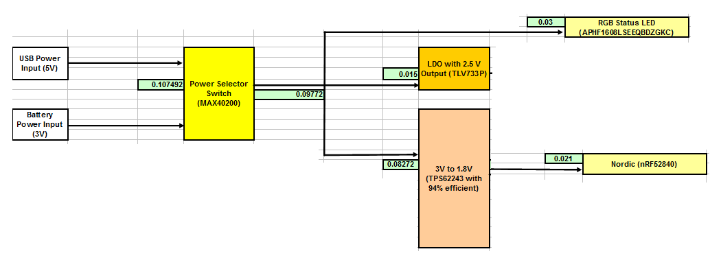

I want to interface RGB LED- APHF1608LSEEQBDZGKC (Kingbright make) with nRF52840 operating at low power mode on 1.8V (@Vdd). The 1.8V external source is capable to drive the RGB LED but is there need of connecting the external transistor circuit to interface the LEDs on GPIO of nRF52840.?
Is the sink current capacity of nRF52840 sufficient enough in low power mode (1.8V) to sustain the switching of RGB LED with If, forward current = 20mA??
Please refer the attached snapshot of the schematic file.
