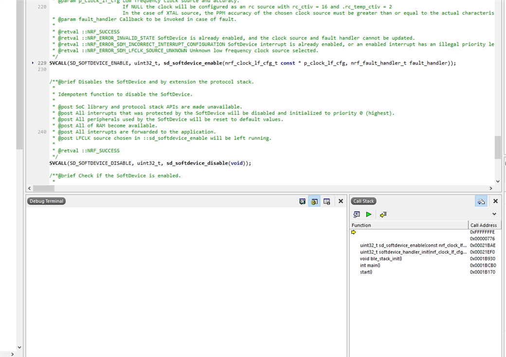

Moved code from uVision to Segger studio for SDK 12.3. Debug code working but Build and Run is not working
I followed instructions given here https://devzone.nordicsemi.com/b/blog/posts/segger-embedded-studio-a-cross-platform-ide
I got it working in Build and Debug mode. However when I use
1) Build and run it does not work. Nor does it work when I load thru nrfgoStudio after merging with mergehex.exe to merge softdevice and my sample code of ble_app_uart
3) After running the code I attached with debugger and saw it is failing at Initializing BLE Stack. Check second attached picture

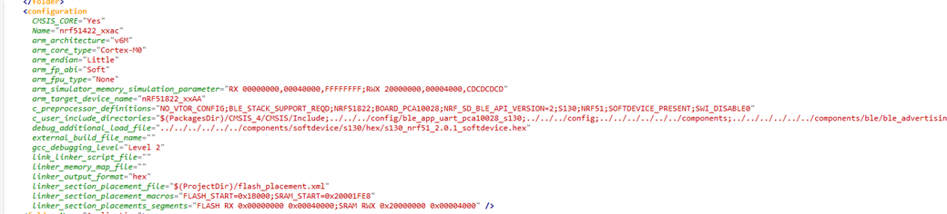

4) Attached my project file options - need some clue what could be wrong.
5) My SDK is 12.3, my board is 51822AA, 256kb flash and 16kb RAM, Using softdevice - s130_nrf51_2.0.1_softdevice.hex
5)same code compiled in uVision works. This is a sample code without modification
