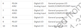

Problem is, there are some pins that I cannot seem to set or clear (i.e. they are tied high or low permanently no matter what code or application I run). I observed that P0.21 is tied HIGH and the code I run does not change that (the pin stays at 3.3V and never gets back to floating even if left unprogrammed). Similarly, P0.6 is tied HIGH and P0.9 & P0.10 are tied LOW no matter what application is running on the board. If I leave these pins unprogrammed they don't have floating value but stay at respective HIGH and LOW states.
The GPIO pin assignments page on Nordic Infocenter (http://infocenter.nordicsemi.com/index.jsp?topic=%2Fcom.nordic.infocenter.sdk5.v12.2.0%2Fgroup__nrf__gpio.html&cp=4_0_1_6_6_7)  says these pins can be used as general purpose I/O. P0.21 especially should be able to be configured as general output pin if I haven't configured it as Reset.
