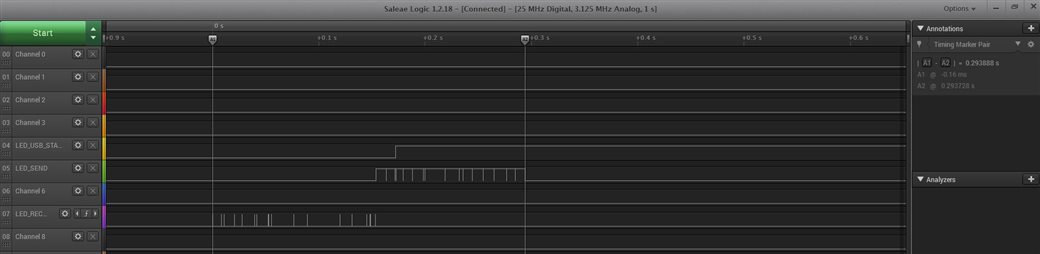

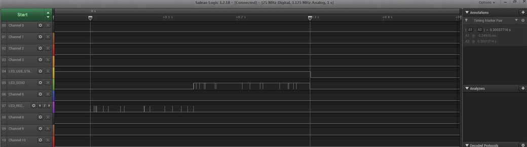

I'm measuring the time spent to send and receive data on the usb device toggling LED's and measuring those using a logic analyzer.
Using LED_SEND to measure time spent on ENDPOINTIN1 and using LED_RECEIVE to measure time on ENDPOINTOUT1.
My understanding from the nRF52840_PS_v1.0.pdf,  usb has to run with the high frequency clock (which is 64 MHz ?) However even I don't run clock_init function (I comment out clock_init function (line#1052) I don't see any differences with the speed. It varies but it is very slow compared to expected bulk transfer rates.  At this point I don't know how to debug this speed issue further. I'm attaching two captures showing the SEND and RECEIVE times with and without hflck enabled. Can you please help with this?

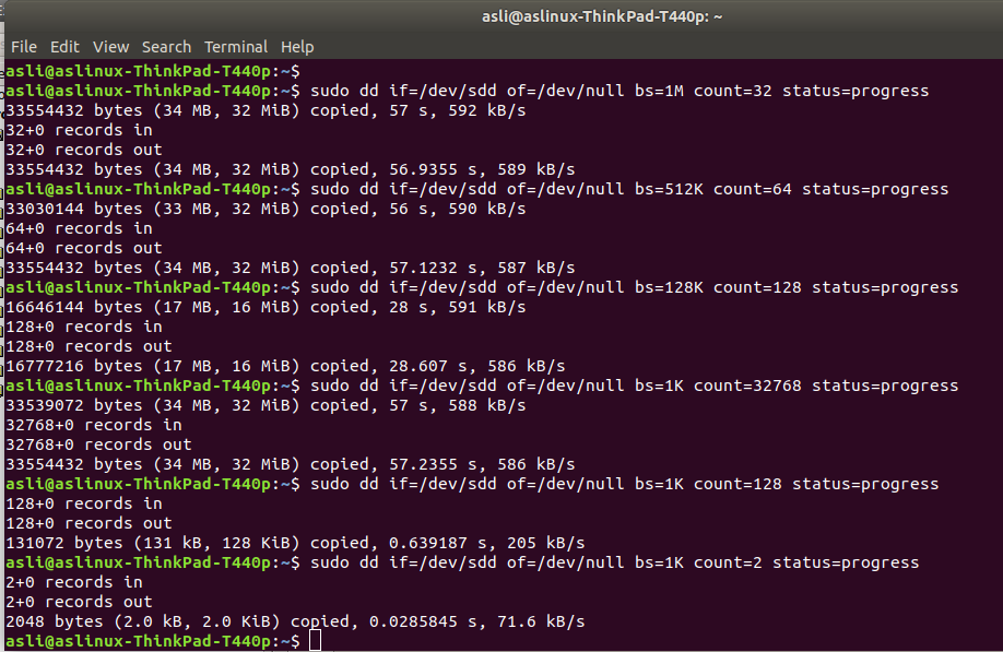

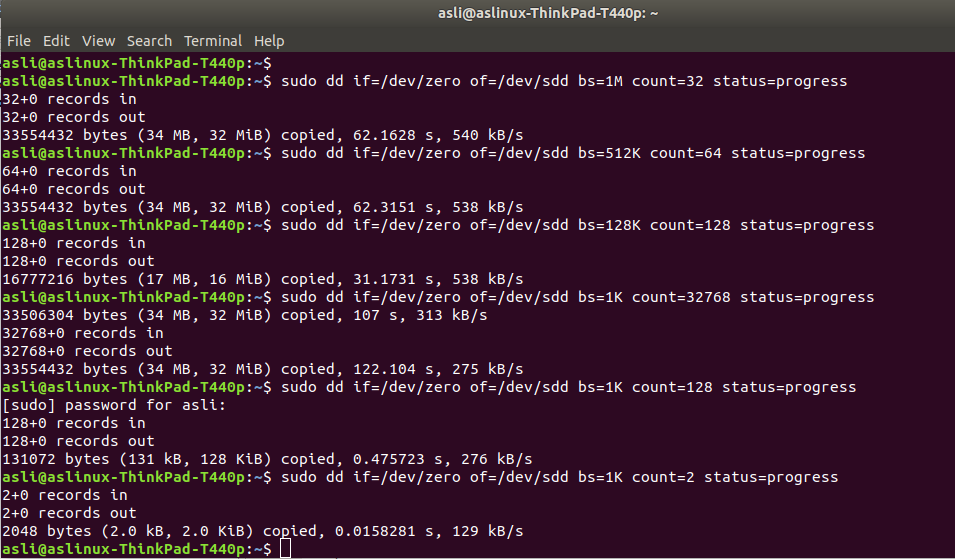

    I tested the MSC device speed as instructed. Attached are the images for Write and Read speed.
    I see a high change (drop) in speed as the block and total data sizes are smaller.
              - Is this speed drop expected and why is it happening?
    Write Test:
    MSC_Write_Speed_Test
    Read Test:
    MSC_Read_Speed_Test
    I'm working on CDC_ACM speed test in order to evaluate it . I'll update once I have the results but please update with Windows example/instructions with >200 KBytes/sec data rate if available.
    Thank you and Best Regards,
    Asli
