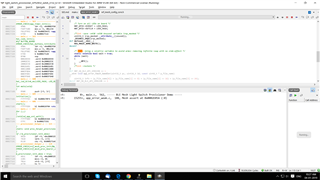

Hii,
I'm using Nordic nRF5 SDK for Mesh v3.0.0 Example Code in LIGHT SW Provisioner Example i got Error code please healp me how to solve.
In Case Of
 #define PERSISTENT_STORAGE 1
if  #define PERSISTENT_STORAGE 0 then works well. i want to store server and client data in stack so please help me out of it.
-Nikunj
  • Hello Nikunj,
    I am sorry, the resolution of your screenshot is very low, so I can't see what it says. But I tested the provisioner with #define PERSISTENT_STORAGE 0, and I didn't run into any problems while provisioning the server or the client.
    Can you please tell me what it says in the log of your screenshot? When did you get the error? When you start the application, or after you start the provisioning (after you press button 1)?
    Did you do any other changes to the project, other than setting PERSISTENT_STORAGE to 0?
    Edvin
  • Hello Edvin,
    Just i run Example code no any changes ,but i got an Error Code.
    #define PERSISTENT_STORAGE 0 instead of #define PERSISTENT_STORAGE 1 its work well.

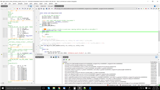

    Thanks .but i have one  query , I'm using LIGHT SWITCH Example code.i want to send LIGHT ON/OFF Command Every 5 Second base on timer interpret instead of button pressed. In this scenario code stuck.
    Best Regards,
    Nikunj
  • Hello Nikunj,
    Have you tried to set up the timer? Does it trigger? I am not sure where the code is stuck without some more details.

    Got an Error below
    If i send command on Button press and only print timer line every 2 sec working ok but when i send command every 2 sec (single Byte oR bool data ) code is stuck.
    Nikunj
    Since this is not the same topic as your original question, I suggest that you create a new ticket. I will try to help you in this answer, but if you are still stuck, then post your issue in a new ticket.
    This is the assertion handler.
    Can you check the status value of your different calls? E.g. status = generic_onoff_client_set(). What is status after this line is executed?
    It may also be your ERROR_CHECK(app_timer_create()) or ERROR_CHECK(app_timer_start()). Try to do:
    ret_code_t err_code;
    err_code = app_timer_create();
    ERROR_CHECK(err_code);
    err_code = app_timer_start());
    and check the err_code after the application calls, and before the APP_ERROR_CHECK();
    Try to debug, and figure out what you are adding that causes the problem to crash. You say that it is when you try to "send command" I am not sure how you do this, but it is probably related to this.
