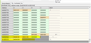

 示例:nRF5_SDK_12.3.0_d7731ad \ examples \ dfu \ bootloader_secure \ pca10028 \ arm5_no_packs
我使用以下命令:

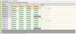

//generate  setting.hex
nrfutil settings generate --family NRF51 --application application.hex --application-version 1 --bootloader-version 1 --bl-settings-version 1 ./hex/settings.hex
//mergehex bootloader.hex settings.hex
mergehex -m bootloader.hex  settings.hex -o FW_multiple.hex
output error:
ERROR: The hex files cannot be merged since there are conflicts.
I try bootloader_secure debug example(nRF5_SDK_12.3.0_d7731ad\examples\dfu\bootloader_secure\pca10028_debug\arm5_no_packs),Bootloader and settings can be successfully merged.
