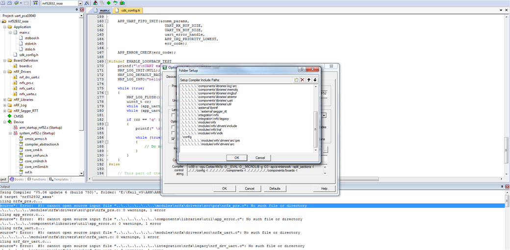

I am working on  ISP1507 which is based on NRF52832. My IDE is Keil V5.26.2.0.  I have had the following problem in the UART example (pca10040e) from SDK 15.0.0. I am fairly new working with all these.
I was trying to amend the UART example according to my needs. However at some point, the application started to reset continuously due an error that I could not have defined. After some research I have found that I have to check the error log written to SEGGER RTT by NRF_LOG (please correct me if I am wrong). I have then tried to get the NRF_LOG working according to the instructions I have found here. However I have stuck.
I have included the necessary ".h" files and their paths. I have also added the ".c" files under "nRF_Libraries" (under "Groups" in "Manage Project Items"). The files I have added, includes some other files which were not initially found by the compiler however, I have gradually added every single missing file. However in the last file I have added, nfc_cli.h, there is a missing MACRO, NRF_CLI_CMD_BUFF_SIZE, and I could not have overcome this one. Where is it defined? What else should I include?

  • Thank you very much for all your efforts. However, unfortunately I have not been able get it work. I open the uart_pca10040.uvprojx and try to compile it, I get 29 errors, it cannot find some of the files. I check the Folder Setup to make sure of the paths. I have confirmed a number of them, I have even reselected some of them but I still get error for them.
    Please see the project section in the left. I think there is problem with arm_startup_nr52.s and system_nrf32.c  under Device.
    Am I missing a setting or something?

  • Hi Denin,
    I apologize, please find attached corrected zip. It shall work fine now on SDK15.2.8524.uart.7z
  • Hi Jakup,
    I appreciate all your efforts and help. However it seems that it still has some missing files. I will work on ble_app_uart and that one has the correct settings for RTT. It works fine. So don't worry.
    Thank you very much for everything.
