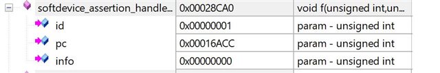

Softdevice assert on S132 6.1.1 on heavy traffic as peripheral
Hi
On our project we see often softdevice asserts with the version 6.1.1 of the S132. The application we have is offering a BLE GATT service that allows fast serial communication and acts as peripheral. We connect it in our test environment with a BLE dongle and force high traffic communication over the BLE service. During the communication we see sporadic softdevice asserts.
The same application works flawless with S132 5.x, but since the update to the 6.x softdevice we see softdevice asserts with the following debug values:
How can we find out what causes this assertion? Does the PC value (0x16ACC) gave a Clou what could be the cause/solution for this?
Regards Adrian
  • Hi Andreas
    Your post gave me the hint I needed. I had to added special code for the softdevice interrupt handling for softdevice 6.x. In that code part I disabled all interrupts for a short (but obviously too long) time.After modifiing the code to only disable the SWI2 IRQ it worked as expected and the softdevice assert disappeared.
    So the case can be closed. Thanks again for the great support also in the year 2019... :-)
    Regards Adrian
