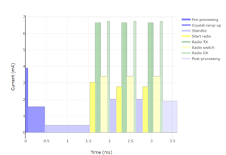

    6) Let me double check this. I believe the same answer applies like I gave in answer 4 & 5.
    Update: The peak modem current occurs when the nRF91 sends data (radio is in TX mode). There can naturally be variations in between sending packets. The current consumption may show a similar pattern to when the radio is in TX mode on the nRF52 (see link):
