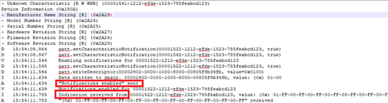

I'm developing a BLE application using nRF52 based on SDK15.2 using Sofdevice S132 under Windows.
The nRF52 is used to send data in notification Format. In order to check if there is a packet loss, I'm using nRF_Connect for android (nRF Logger) to view the data received
My service supports the properties identified below :
  • read
  • Write
  • Write_wo_resp
  • notify
  • indicate
As shown in the figure below,  despite that only notification is enabled, nRFConnect identifies that an 'indication is received'.
https://devzone.nordicsemi.com/resized-image/__size/800x240/__key/communityserver-components-multipleuploadfilemanager/6d610c01_2D00_5b5c_2D00_49a9_2D00_bcd1_2D00_8826950b9bfe-26801-complete/pastedimage1546875260427v1.png
When making indication propriety as disallowed,  nRF_Connect identify that 'notification is received'.
  • Is this the normal behavior?
  • Can that cause packet loss, knowing that there is packets loss when making indication permitted?

  • Hi Hung,
    Thank you for your quick reply.
    I don't think that the operating system can cause a packet loss, In fact, No packet loss is detected when making indication propriety deactivated (using the same smartphone).
    Besides, we tested with many Android smartphones (Samsung S8, A8+,S7 edge ...) and we get the same issue.
    Likewise, with nRF51 we got the same issue of packets losses only with nRFconnect for android but not with nrf connect for PC.
