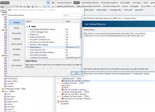

I want to test the mesh provisioning demo with the codes provided on the GitHub:
https://github.com/NordicPlayground/thingy52-mesh-provisioning-demo
I have encountered an error while compiling the codes of "light_switch_proxy_server_nrf52832_xxAA_s132_6_0_0.emProject"  in the folder <thingy_provisioning_demo_generic_OnOff_BLINK> using Embedded Studio for ARM.
The error is as shown below:
Building ‘thingy52-mesh-provisioning-demo’ from solution ‘thingy52-mesh-provisioning-demo’ in configuration ‘Debug’
  Compiling ‘main.c’
    m_ble.h
    m_ui.h
    main.c
    "SLAVE_LATENCY" redefined
    main.c
    this is the location of the previous definition
    m_ble.h
    m_ui.h
    main.c
    "FIRST_CONN_PARAMS_UPDATE_DELAY" redefined
    main.c
    m_ble.h
    m_ui.h
    main.c
    "NEXT_CONN_PARAMS_UPDATE_DELAY" redefined
    main.c
    "MIN_CONN_INTERVAL" redefined
    main.c
    "MAX_CONN_INTERVAL" redefined
    main.c
    m_ble.h
    m_ui.h
    main.c
    'DEV_BOARD_LF_CLK_CFG' undeclared (first use in this function); did you mean 'NRF_RADIO_HFCLK_CFG'?
    each undeclared identifier is reported only once for each function it appears in
    implicit declaration of function 'execution_start' [-Wimplicit-function-declaration]
  Compiling ‘rtt_input.c’
  Compiling ‘mesh_app_utils.c’
  Compiling ‘nrf_mesh_weak.c’
Build failed
Completed
I have followed the steps shown in the Demo-page. However when hitting "Build & Run", the error message is triggered.
I sincerely appreciate your effort and time for looking into this matter. I am looking forward to your reply.
Thank you.

    I have tested the demo and it seems to compile with no errors. You might have forgotten to rename the file pca20020.h in SDKv15. Have a look at step 4 under "Building the demo" on Github. After you changed the name, do a clean before you build again and it should compile fine I think.

    Thank you for your reply. I have actually remove the file pca20020.h in nRF5_SDK_15.2.0_9412b96\components\boards instead of renaming it. It should do the same right? My folders look like this:

    I couldn't find the declaration of the variable 'DEV_BOARD_LF_CLK_CFG'. Thanks again for your attention!
