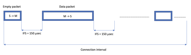

  • If I may summarize above discussion:
    SD has priority 0 which can't be changed (it is not exposed to application developer) and its interrupts should not be masked
    According to link connection interval (aka timing deviation) can be (1M bits PHY) between  ~ 0.5  - 2.5 mSec      ( for empty packet  and 247 Bytes data packet, respectively).
    ->  time constrained tasks can't be run as part of the application or their timing should be flexible enough for timing deviation caused by SD.
    1) Do I miss something?
    2) Does using Beacon which its transmission time can be controlled by application is practical for workaround this issue?
    3) Any other suggestion for solving this issue?
     This is absolutely correct.
    Can you please tell me more on why you think the softdevice activity will be different in the case of a Beacon? I think beacon is just a special type of advertisement and the underlying softdevice activity is similar to advertising role of the device.
    You can disable the softdevice (get disconnected) and have your motor task running and buffering the results that needs to be transmitted to the peer. Else you can use a long connection interval, in which case you will have a lot of slots between each connection interval for the motor controlling task to run and once every connection interval, the motor task will be masked by the SD. If your application can survive this, then it is currently a simple work around to just increase the connection interval to say 200ms and you will have your motor task running for 200/3 = 66 times before it is blocked once (maybe twice).
    If the above scenario does not fit your needs, then you need to have a dual core system where the BLE stack is running on one and the application has a dedicated CPU to run its time critical tasks.
