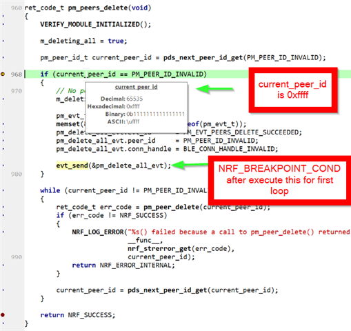

How to delete all pairs in connection
Connecting.
How to delete all pairings
    My ble_app_hrs_freertos also encounter NRF_BREAKPOINT_COND in debug after run pm_peers_delete. Please advice.
    HW: PCA10056
    SW:nRF5_SDK_15.2.0_9412b96
    example: ble_app_hrs_freertos

    /**@brief Clear bond information from persistent storage. */
    static void delete_bonds(void)
        ret_code_t err_code;
        NRF_LOG_INFO("Erase bonds!");
        err_code = pm_peers_delete();

    I checked, it didn't even completed progress through the whole pm_peers_delete function. The NRF_BREAKPOINT_COND  happens when  evt_send(&pm_delete_all_evt) is called.

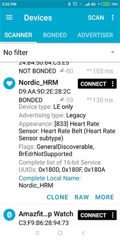

    My device already pair with the phone via nrf connect mobile app. Not sure why it shown no peer id
  • evt_send calls the event handler of the first event handler registered through pm_register (first loop), this might be the function pointer in m_evt_handlers[0].
    That event handler is the next clue of our mystery. I'm guessing that it contains the APP_ERROR_CHECK that processed a non-NRF_SUCCSESS return code, thereby calling the error handler.
  • Thanks. What should I do next, I kinda out of idea about this. As the whole driver code is like a black box to me.
    Here is the debug crush disassembly.
