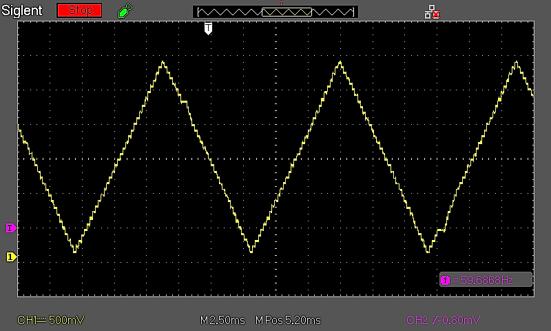

I am having difficulty using a single TWI to support a DAC (MCP4725) and IMU (BNO055).

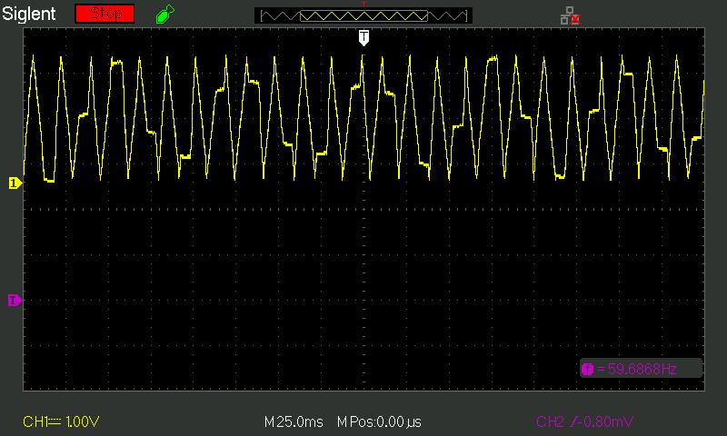

I am using nRF52 DK, and SDK 14.3 with the SEGGER IDE.  The DAC is running on a timer with samples being loaded every 200 micro seconds.  The IMU is running on the same TWI bus and I am collecting 3 data samples (2 bytes each) every 20 milliseconds.  The data is being piped over BLE at 50 samples per second (packing 2 sets of samples in a single 20 byte packet every 40 milliseconds). If I output a triangular waveform, I get an artifact every 20 milliseconds with a varying time for the length of the artifact (see the attached images below).
My plan is to split the processing so the DAC is on one twi and the IMU on a second TWI bus.  If I do this, what pins can be used for the second TWI if I use the default pins for the first TWI?  Below are my initialization functions:

As you can see, the amount of corruption in the waveform varies.  Sometimes it is very obvious and sometimes almost undetectable.  Occurring every 20 mS indicates that the transfer of data from the IMU is impacting the ability for the DAC outputs to continue at the 200 microsecond intervals (they get delayed and thus the horizontal corruption in the DAC output).

    The dual TWI masters works well - I still have under 1 mS distortion during transmission of samples over BLE.  The DAC samples involved in the delay are buffered and the waveform "catches up" by sending the samples out faster than every 200 uS.  We can live with that for now.
