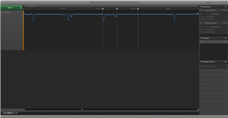

Time slots denied for 6-8 ms after each connection event on central device
I am using the S140 softdevice on NRF52840.
I am using NRF 5 SDK 15.2
As part of evaluating NRF52840 for a product I want to see how well i can perform proprietary accurately timed regular data transmissions (would be audio streaming in the product we want to develop) while my NRF 52840 is connected to 2 peripheral devices via the softdevice.
To do this I am using the Time slot API.
For my evaluation I am requesting a 600 us time slot every 10 ms. When the time slot is denied, i request another time slot 20.1 ms later (The added .1 is to try and move my 10 ms time slots so they might not collide with softdevice traffic in the future).
I see a large amount of denied time slots, and my .1 ms time modifications does not help me find a timing sweet spot to avoid that the soft device denies many of my time slot requests.
I have observed the BLE transmissions and the time slot patterns by measuring the NFR52840 power with an oscilloscope.
I am seeing that after each connection event Tx to the pripherals, the softdevice will deny all time slot requests for about 7 ms.
This leaves me with the following question:
1. Why does the soft device deny time slots for about 7 ms after each connection event transmission? It seems like an excessive time, and it prevents me from regularly transmitting my proprietary data.
2. Can I change and minimize the amount of time after connection events that my time slots are denied?
I have attached screen shots of my power measurements. The large dips (it measures voltage over a resistor, so larger power draw is lower voltage) every 10 ms is my proprietary transmissions. The smaller double dips are connection events (I assume). It shows how the time slots are denied (gaps in the 10 ms pattern) for about 7 ms after each connection event.I have attached my Central device source code and .hex, .map and .out  files. (it runs on nRF52840-DK board)
I have replaced the 2 connected devices with the Blinky peripheral example code to ensure the issue is not related to the peripheral device I am connecting to, and to ease support.
My evaluation application is originally based on the Blinky central example, but has been modified quite a bit.

    Whenever I am granted a time slot, I start a timer, and set the compare time to shortly before the start of the time slot that I request as my next time slot. If the next time slot is denied, I request the same time slot again in the timer IRQ triggered by the timer compare event.
    With this concept I am granted time slots down to around 830-840 us after the SoftDevice starts its connection event radio activity (I measure the timing via changes in power consumption, so it may not be entirely accurate).
    According to Stian, bad connections will lead to re-transmission, in which case the softdevice will use a larger portion of the 2.5 ms time slot.
    Stian speculates that radio notifications indicating soft device radio activity ending may be useful for requesting the next time slot, but one would have to experiment to clarify when exactly the radio activity end event occurs (end of granted time slot, end of radio activity). I haven’t tried that yet. (http://infocenter.nordicsemi.com/topic/com.nordic.infocenter.s140.sds/dita/softdevices/s130/radio_notif/radio_notification.html?cp=2_3_2_0_10)
  • Stian and I found a solution.
    First of all, set the NRF_SDH_BLE_GAP_EVENT_LENGTH to ‘2’ as described earlier in this thread, to minimize the time the softdevice reserves for each connection event. That will get the softdevice reserved time down to 2.5 ms per connection event.
    To get radio time closer to the connection events, a solution is to try and get the time slot at the very last time possible, because there is a god chance that the SoftDevice is already done with the connection event, and has released the time slot early (I assume the SoftDevice connection handlers use the same time slot API that is exposed to the application).
    I implemented a prototype of that concept, and it works! :D
