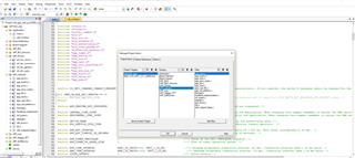

I am having a problem using pwm with ble_app_uart example, let me explain, I want to control a servo motor via Bluetooth, so I use the ble_app_uart example to communicate via Bluetooth, and to control a servo motor I need to use pwm output, so I tried to add the pwm Library to my ble_app_uart project, I Added the file to the project items :
also I Added the file path to the included file paths :
I have also set PWM_ENABLED 1 and APP_PWN_ENABLED 1 in sdk_config.h
I have check that I Don't have the sdk_config.h twice of that PWM_ENABLED is not defined somewhere else,

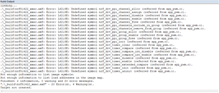

and I Always have the same error (20 errors actually) :
I have no idea what is going on, any idea is welcome,
