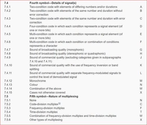

Does anyone know what are the TRC-43 classification of emission section 4th and 5th symbols   (see below list for options) for device which is based on nRF52832 and acts as BLE server only.
Thanks in advance
  • For my humble opinion (correct me if I am wrong) the TRC-43 full classification of emission should be W7D  (1st, 2nd and 3rd symbols - see below for details) and no symbols for 4th and 5th symbols

    This should be similar to the standard emission designator, which is 2G40 G1D or 2G40 F1D for nRF52832.
