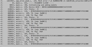

    I think it will be easier to start with one of the Mesh SDK examples, rather than starting from scratch. The handles you will get from the provisioner. You need to provision your devices in order to communicate between them. To provision you can either use the light_switch->provisioner example, or you can use the nRF Mesh app for mobile. For a simple description on how to use this app, please check the youtube link on this site.
  • Hi Edvin, I am running the sample light switch. I am capable of using the  mobile app and can provision a mesh network. I would like to know if the above simple_message implemented in the light switch  example will work. However I dont want to send to all nodes just 1
     My problem with the above code is Im stuck with a compile error
    m_central_handel is for some reason not declared
    If you can assist me to get this working it would be great.

    /* Start listening for incoming packets */
        nrf_mesh_rx_cb_set(rx_cb);
    static void initialize(void)
        __LOG_INIT(LOG_SRC_APP | LOG_SRC_ACCESS | LOG_SRC_BEARER, LOG_LEVEL_INFO, LOG_CALLBACK_DEFAULT);
        __LOG(LOG_SRC_APP, LOG_LEVEL_INFO, "----- PCA10059 CLIENT -----\n");

    //get this device UUID PCA10059
        const uint8_t *p_uuid = nrf_mesh_configure_device_uuid_get();
        UNUSED_VARIABLE(p_uuid);
        //strncpy (scanner_UUID,p_uuid,17); // copy the uuid
       memcpy(scanner_UUID, p_uuid,17);
        __LOG_XB(LOG_SRC_APP, LOG_LEVEL_INFO, "Device UUID ", p_uuid, NRF_MESH_UUID_SIZE);
