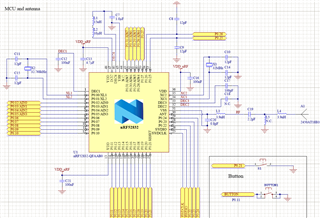

 I have developed   new board (4 pcs) for nrf 52832 and soldered all parts from murata basic developers kits.
If I  touch  after flashing of chip to  X2 (marked on pcb with whithe clour) I see short time bluetooth name on  nRF Connect, but I have not any connection. All pins are checked dont found any issue.
I  can flash chip  without any issue. I am using nRF5_SDK_15.2.0_9412b96 =>pca10040  (ble_app_blinky) example without any change.
My flash process:
I have    deleted  chip  first with RFgo Studio (erase all) than  debuged the  example with segger studio and written to chip. Should do anything
What   is wrong in my process or device?
