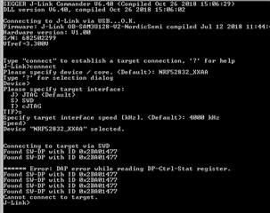

I got the problem to connect customer board(nRF52) via SWD.
My connection should be fine and customer board is also supplied 3,3V by external power.
How I wire 52Dk with customer board.
52DK(pin20)                  Customer Board
Vtag    ----------->                 Vdd ----------> 3.3V external power
GND    ----------->                 GND---------> ground with external power
CLK  -------------->                 CLK
DIO----------------->                DIO

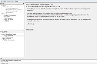

I try to use nrodic command tool to recover customer board. It didn't work.
And I also try to use nRFgo but it show "unknown error"
And here is the error when I try nRF connect.
